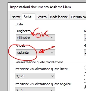

second thing where it is possible to set the value of the corners in degrees??? Why importing step1615575312131.pngthe measuring units of the corners is setatta in radianti
Autodesk employees seem to be working to solve this... but without success.
