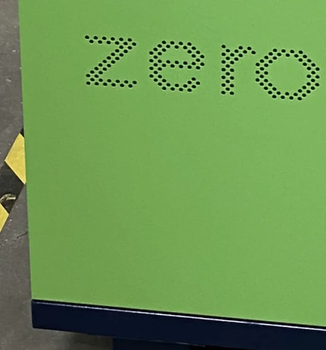

Good evening.
how to create texts through holes in sheet metal solid edge environment?
I apologize for ignorance, but I recently changed work and so far I never needed to use this function (if available).
allego photo of example.
thank you so much to those who will and will want to help me.
hi, to do what you ask, you have to take advantage of the possibility to exclude "regions" of the sample command. the steps to follow are as follows:
- create sheet metal
- create a sketch and use the command "profile text" to create the writing with the desired font
- to make a hole of the desired ø
- make a sample of the hole to cover all the text
- in the sketch of the sampling include the text profile, with "wireframe tangent" option takes it all in just one click
- in the sampling options use the "sopprim regions" function and select the profile included
- use the reverse button to exclude elements outside the region
attach images and sample files

Forgive me, I can't open the file because it looks protected. How do I set tangent sketch?
You can't open it probably because you have an older version of 2022 I use.
Sorry my mistake, the option is called "wireframe tangent"
I'm still sorry to bother you, but I didn't have time to try...
So if I didn't understand badly, the rectangle on which to make the filling sampling should be drawn through sketch and not directly from the sample command?
no, it's the text profile that needs to be done in a separate sketch, otherwise you can't use it to define the sampling region.
