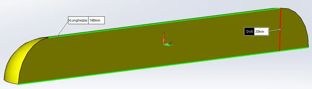

doing the right configuration I managed to set the measures I need and make the wound without fitting.
But there are still problems.
as you can see the forming tool is wide 200 and high 20.
However, by checking in the model these odds do not return and increase both.
I guess it's not normal for this to happen.
What could I be wrong?
other thing is the depth of the wound.
It seems that the depth is blocked and cannot change it.
I need a 20- and 14- deep wound.
