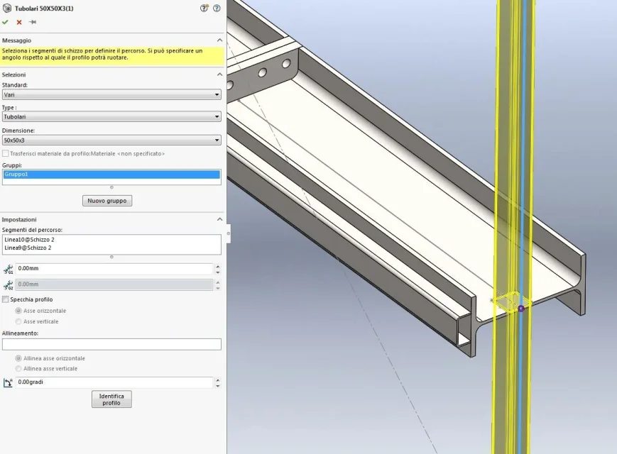

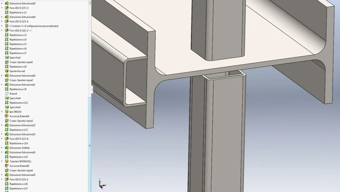

I was modeling a structure in part multibody and I make my usual changes since I am designing it. I realize at some point that makes me see a body that shouldn't be there. I'll attach pictures to make you understand the problem that I just don't understand. . .
as you can see there is a "overlapping" of profiles.. .
Here you can see the word "curious that stays with me." .

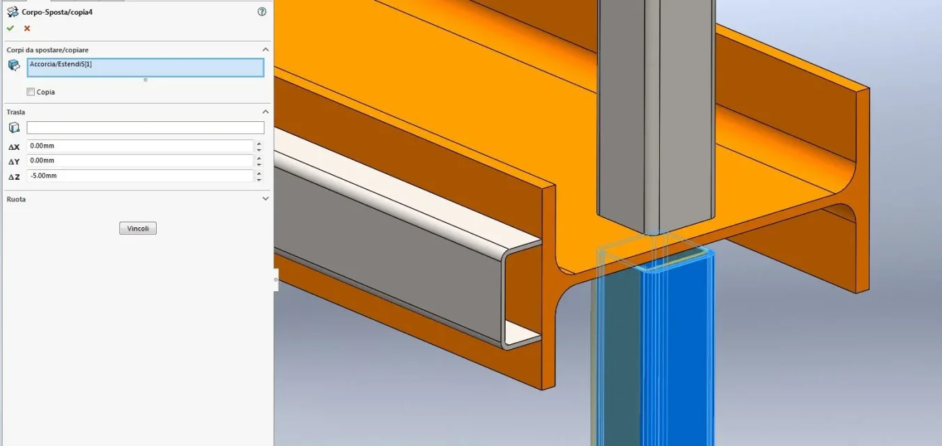

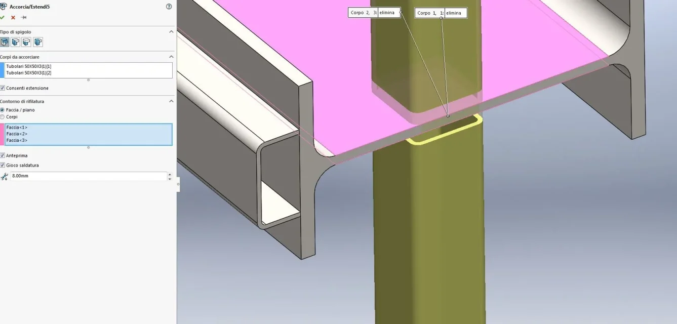

The functions I did to create those bodies were these.
creation of structural profiles. . .
cut profiles in correspondence of the soul of the ipe with the short/extended command.. .
moving the body...
the result is what you see in the first image, clearly wrong. I have regenerated and edited several times these functions but always get the same result.
