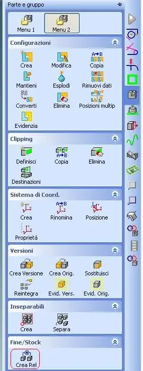

if you want less cheated pre-worked management then you should use the stock end function that is at the bottom of the second page of the submenù part groups of fast menus (those that disappear with f9).
this function does nothing but relate the preworked with its finite; preworked that by default disappears, that when weighting the finished is not added, but that it is always there and with management parts you can make it appear, even in the design of the particular.
the only problem is that it is a distinct object so if you move the hole in the finished and forget to move the hole on the preworked he remains in the wrong position. in this case you can come to help the "parametric relationships", if of course you have the parametrics module and then impose the coaxiality of the raw hole of the preworked with the alesed one of the finished etc. etc. and every time you load the particular ensure that the relationship is blue and not green (unfortunately I did not find how to impose the automatic update of the relationships, but I think there is the way to do so)
