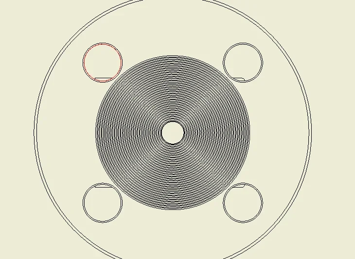

those are the signs of a turning made of disgust; The only thing you can get from such processing is to ruin the tool.@gstud try to give feedback to your discussion, do not do as in the other from which you disappeared
the image clearly shows that it is a flange with calibrated orifice. the sealing surface is not turned badly :) is made in order to ensure the seal by affecting the relatively soft seals used in the chemical field, it is called phonographic strip and is defined with the values below:1650658587900.webp
@ cadinpiedi, thanks for the explanation. I make amends and apologize to the flange performer.
Thanks for the answers, I initially thought about the zigrination but I was not completely certain because in the uni149 it does not refer to this type of processing. I would have made a mistake.
then proceed with a section and I go to quote the angle and step as shown in the image.
