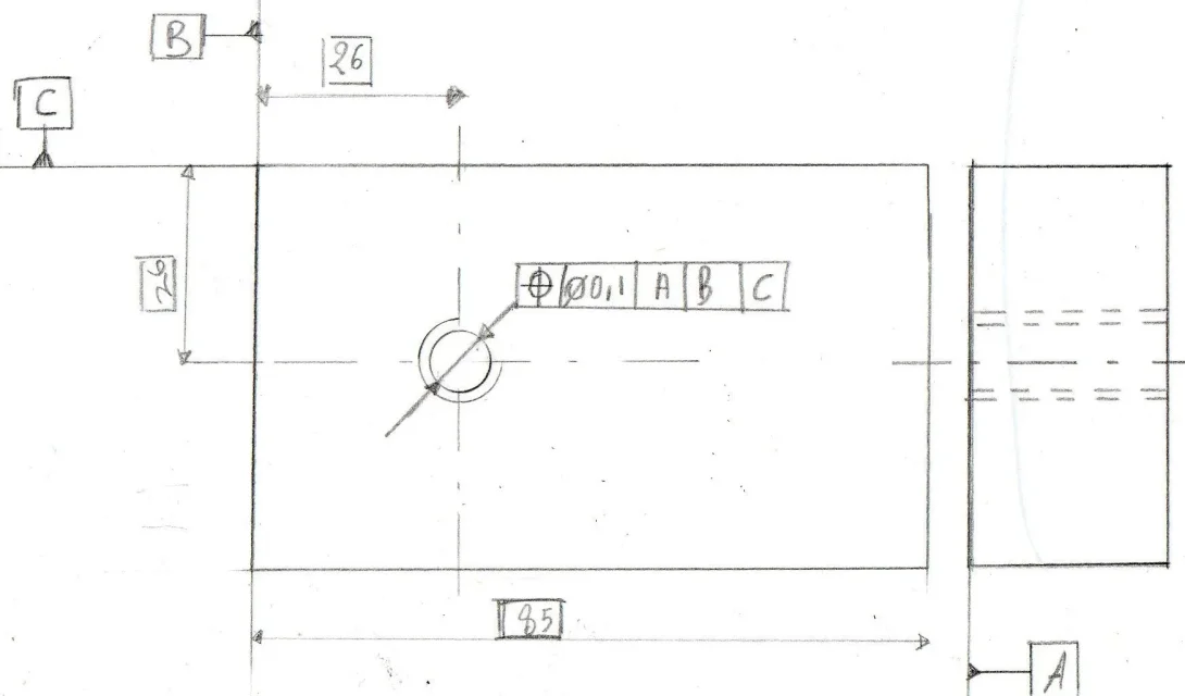

represent and quote (sizes to taste) a perforated plate with fil hole. blind blind
  • Thread starter Thread starter marcolino91
I am not sure (and I ask confirmation) but I would not use the section line as a reference line for the quota... I think an axis can be used as a reference line... but a section line I have my doubts. I think it was as good as you did in the first drawing you posted... with the location of the hole center in a view and the specification of the hole (depth and various stuff) with a tear in the side view.
I'm leaving the tear... with the partial section you do not need to indicate the section plan?

I remember that in these cases, the possible axis is extended, outside the track of the section plan, and it is used to quote.
an example in the annex: If the piece had not had the wings framed in red, I would have inserted the quotas in green.
Is that wrong with you?
increasing difficulty. .wanting to apply a localization tolerance to the hole... You do this, don't you?
the annex is the bad copy... and see:)

for truffle80:
Good objection. stimulate my memories (now blurred) of technical design. I (but I repeat it is not bible because it has passed a lot of time), in case there had not been the wings up and down I would not have prolonged the line of section as a reference line for a possible quota... following the rule for which the reference lines for a quota can be only 1) axes of symmetry 2) boundary lines of the piece. In that case I would have located the hole in the view from above and would have quoted its peculiarities in a torn side view. But I repeat... I also have doubts about this... and I could be very sorry... I feel like it! :
for marcolino91: I think tolerance is inserted correctly.
