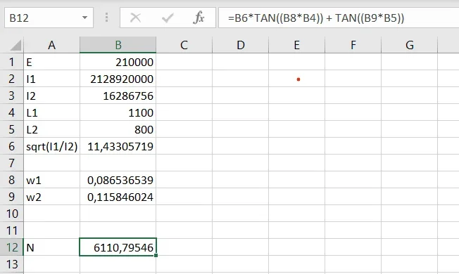

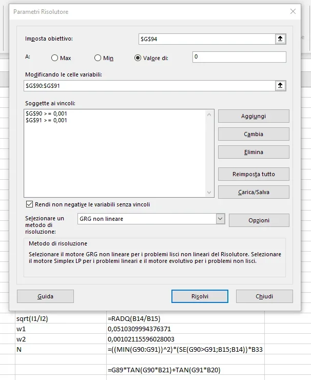

I do not agree, if n=0 means that buckling is there regardless. what is sought is precisely the critical value of n, what generates buckling. If it were zero it would mean that any applied load would generate buckling. in fact the comparison load comes from the reduced critical load of opportuni coefficients. if the actual load is < of the comparison load, there is no buckling.
