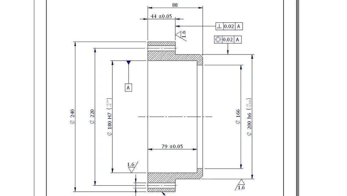

I'm a mechanical engineering student and I'm using solid edge to table a project for a design exam, the system I know a little because I used it in a assisted design exam.
My problem is to assign references for geometric tolerances, as long as the references are of the external surfaces of the components no problem, the problem arises when I want to assign the reference e.g. to the axis of a cylindrical flow, the system seems to fail to "attach" the measuring line and place it a little randomly, as in the attached image.
I am interested in getting the correct formatting of the reference, only that in the guide is not reported much about it.
What's wrong?
Thank you very much.
