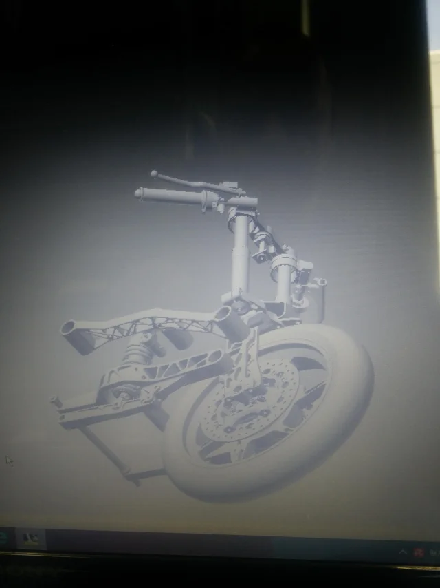

I didn't do it....but you had the skills. ..that of the photo is the original project of the fork that was downloadable from the internet until some time ago
