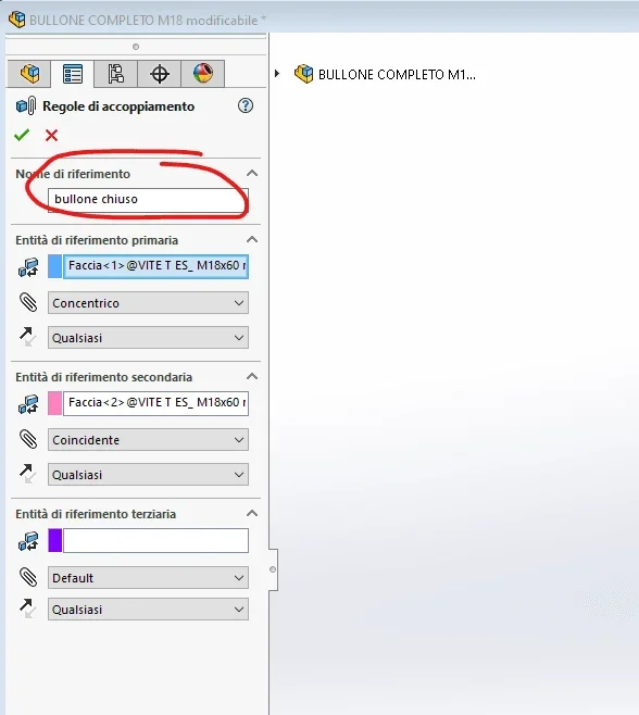

to me it does not recognize holes with that system only when the coupling part is a body or holes are made with the cutting command, so it does not recognize the feature reference hole.I resume the theme on pre-set couplings. I would also like the drag to be placed as it happens in routing environment, but I don't know why I don't work. I set the mating rules I would like for the bolt example I attach. I tried the example of a and b of mass and that works, also inserting part b in another environment. but not mine, do not recognize the holes when approaching it
