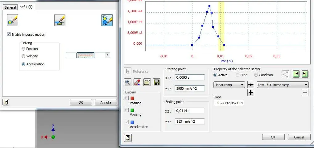

for the rest you can control the acceleration of the joint pulse that interacts with your spring. even better if you know the law/performance of the same impulse.

Yes, thank you. works perfectly, I also compared the results with analytical calculations.
