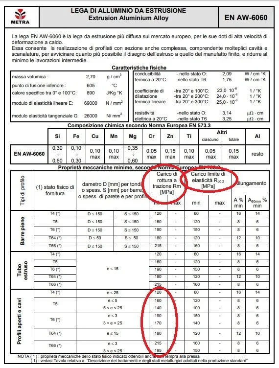

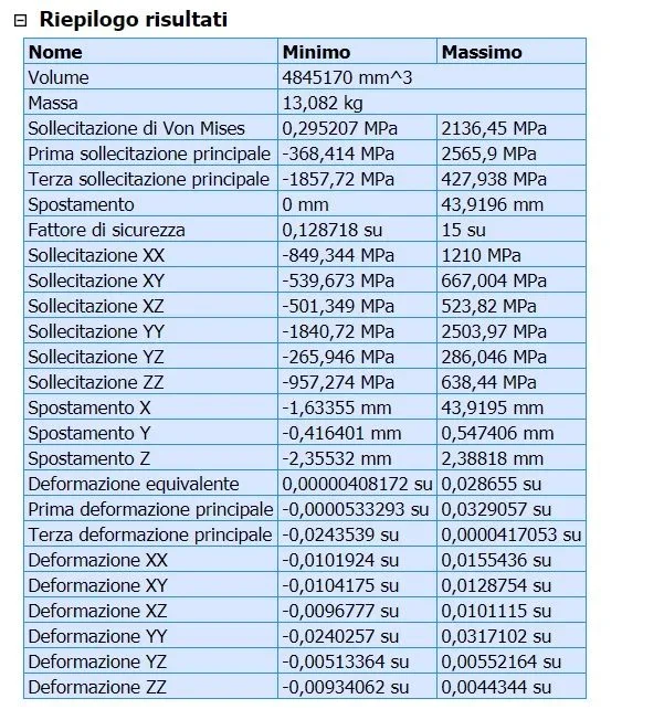

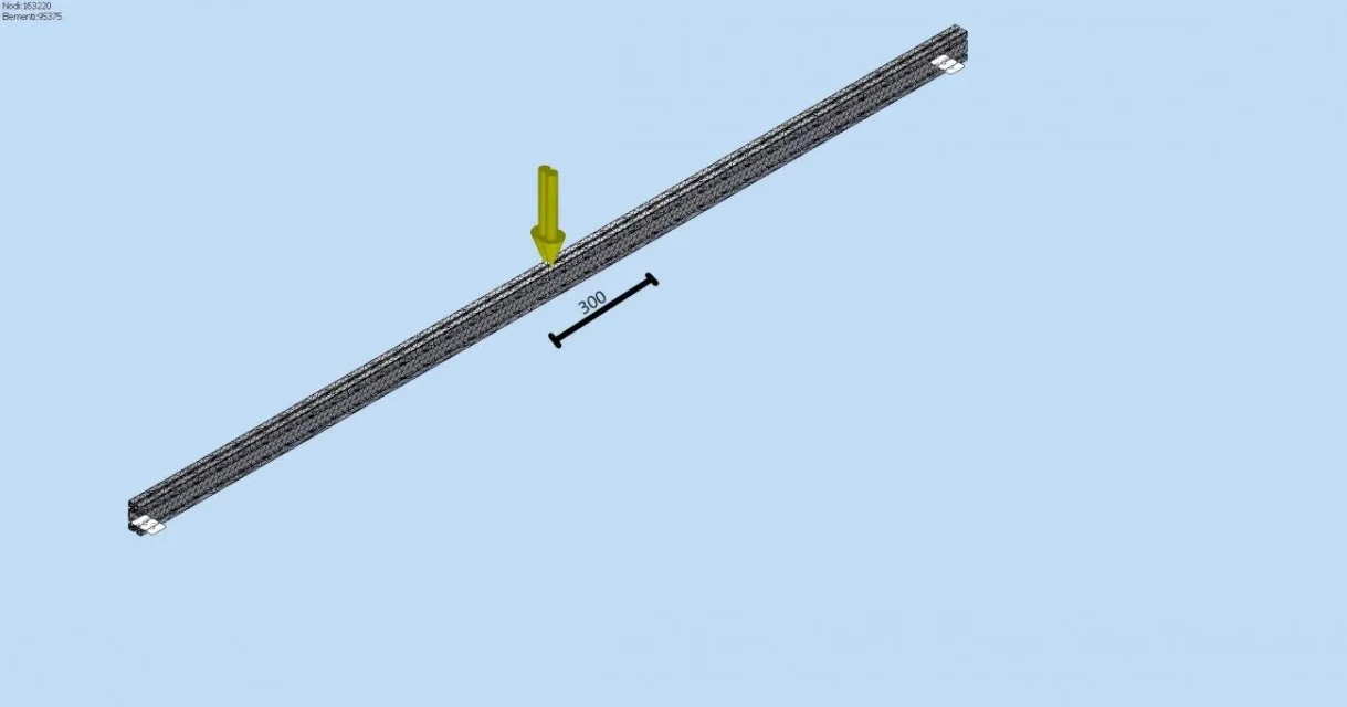

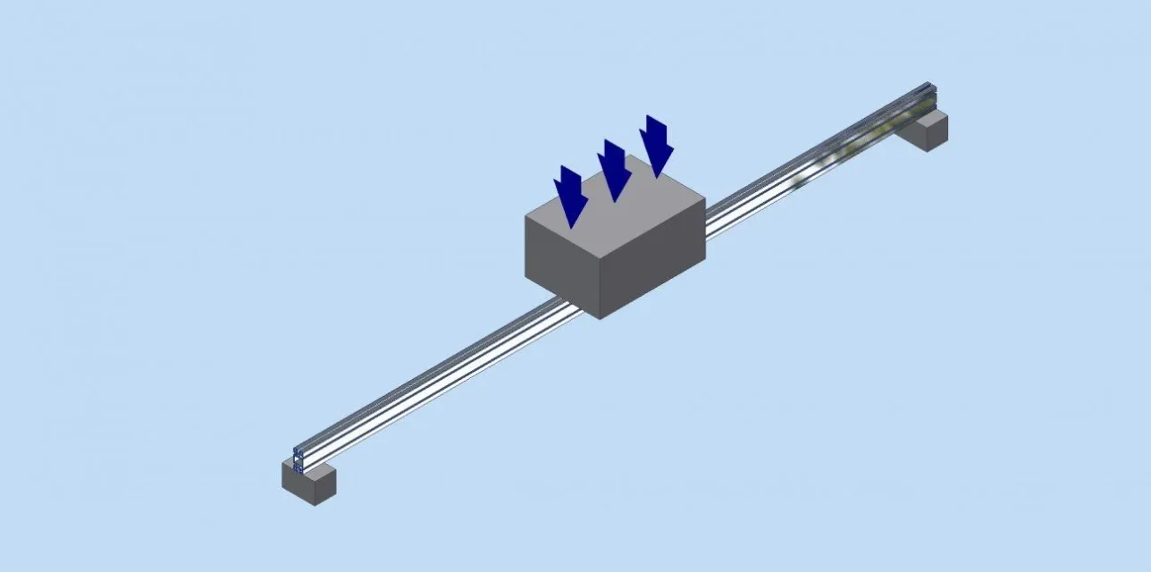

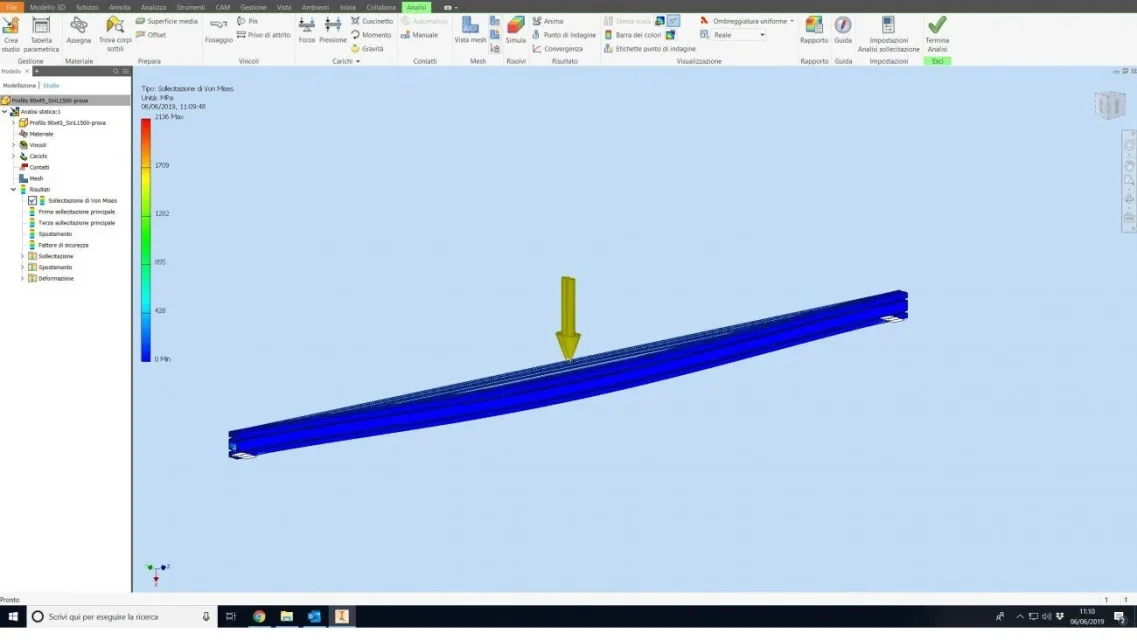

I simply need to understand how much an aluminum profile holds, which rests at the extremes 100 mm dx and 100 mm sx with a load above. I opened the environment and gave the material to the profile. I immediately got stuck with the constraints to put. I could not put a bond to the right and left of the particular; I flew so over by extrusion and selecting the extrusion face. I tried to put 100 n - 500 n - 5000 n but after making the simulation the piece seemed only to be very small. I set the real scale but it still leaves me doubts and perplexities. if someone can indicate me a guide or can explain me in small steps how to do it makes me a great pleasure. thanks to all and good eveningaaa
