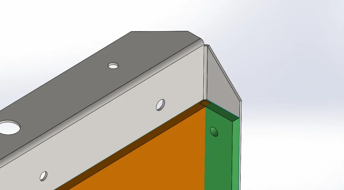

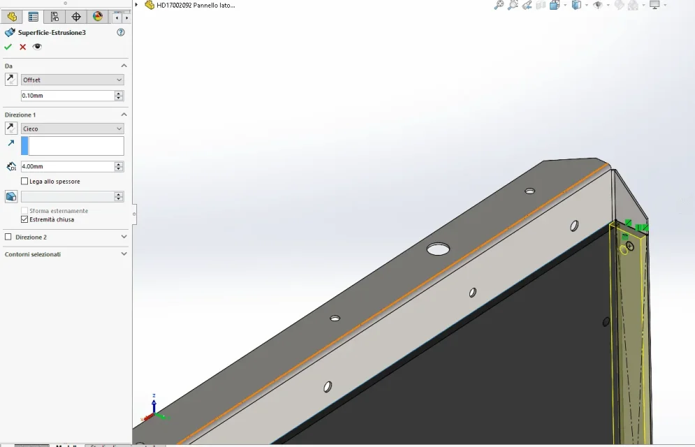

I have two surfaces that come into contact, I need to create a unique body and then convert faces into a folded sheet!

the surface would be insulation on the sheet, I need to reverse engineering on the surface to create a sheet! only that doesn't make me bend because it finds the intersected surfaces

plate and insulation attachment: first figure original surfaces, second I copied the surfaces, third cut on themselves, fourth thickness and converted into sheet metal.
