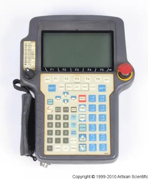

teach pendandt"teach pendant" is the common name with which reference is made to the programming keyboard. each manufacturer then uses its own name "flex pendant" or "kcp" etc.
the teach pendant serves for the programming of the robot. Although particularly complex software is commonly written and tested to the PC with specific software, the teach pendant is however indispensable for changes in the field, for manual handling of the robot, for operational testing of programs, etc.
depending on the costructure design can change heavily, but in principle it consists of the following parts:
screenthe teach pendant matches a display on which you can see the program code and navigate between the menus. some manufacturers have a very comfortable and robust touch screen display, specific for industrial environment.
emergency emergencythe teach pendant always mounts on board an emergency fungus. This is imposed by the legislation, which prescribes a fungus in every workplace, and the tp represents a mobile workplace.
some manufacturers have the key mode selector on teach pendant. Unfortunately not everyone has it while being extremely comfortable, especially when working near the robot in the field and the controller is in the square room, maybe on the upper or lower floor. if the selector is on the picture, switching from automatic mode in manual and vice versa means making stairs, stairs and still stairs.
joystick or motion buttonsthe robot can be moved by performing the program, but obviously it must be possible to move it also manually to take it to the desired position, and maybe then record in the program such position. to do this there is a set of buttons, and very often also a jostick. there are multiple modes of movement, for example in the joint space, then "move axis 1" or "move axis 2", or in the operating space, for example "long advance x", "long rise z", etc. you choose the mode of time more comfortable.
tastieraif the screen is not touch screen, the teach pendant has a real qwerty keyboard. for those instead with the touch screen it is monitored, and the physical buttons limit themselves to the "play" of the program, to the "stop", to the "pause", to the function keys, etc.
useless to say that I personally find those with the touch screen much more comfortable.
hold-to-runis the most important button on board a flex pendant. When the robot is moved in manual mode it is vital that the programmer, enabled to be inside the robot's risk zone, remains conscious and able to intervene promptly on the robot at any time. during the movement of the robot, through the execution of the program or the movement with the joystick, it is necessary that the programmer has in hand the teach pendant, so as to be constantly able to intervene and stop the robot if necessary. he must then hold the hold to run button (also called "dead man") in the middle of his race. if you lay the teach pendant, or you run it by hand, or stumble, or faint, the hold to run button is released and the robot stops immediately. if it is stained and the tetanization of the muscles of the hand make it contract, the button is pressed to the bottom, stopping the robot in any case.
connection to the controllerthe teach pendant must of course be connected to the controller. typically the connection is formed by an ethernet cable for the display (which is actually a small indusrial pc), and a series of corders for the emergency fungus, the modal selector etc.
There is only one case of a well-known Italian robot manufacturer that offers a teach pendant wireless. There are those who speak well, and those who speak badly. certainly it is undeniable the comfort of not having cables between the feet that twist and fill with dust, but it must also consider negative aspects. first of all the weight. work for hours with a teach pendant that weighs twice as much as a wired I assure you that also makes shoulder and elbow. and then the batteries are discharged and recharged. Of course, the batteries last 8h (when buying!), i.e. a turn, and then there is the spare pack. camera batteries last even more, but how many times did you find them discharges just when you needed them? and in this case if you download the batteries, the emergency fungus is virtually "premute", stopping the robot.

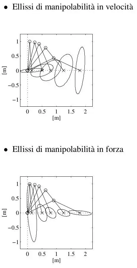

ellipsoids of manipulationcynetstatic duality can be seen geometrically with an elegant and interesting instrument, i.e. the ellipsoid of manipulation. In fact the ellipsoids, let's see why. This tool can be used both in the design phase of the robot to evaluate its dexterity, and in the planning stage of trajectory to understand if it goes into "poco destre" areas.
we are in the space of speed to joints. we imagine drawing a sphere with center origin and unitary radius (of course we speak of a hypersphere of size equal to the number of joints of the manipulator). we can write the equation of this sphere as a standard of speed equal to one:
* q' = 1
but as we know that v = j(q) q', then the above equation becomes:
v(transposed) * [J * J(trasposto)]#1 * v = 1
that is the geometric representation of a quadrica, for the accuracy of an ellipsoid (in size) defined in the space of speed in the operating space. through the mechanical structure of the manipulator, in short, the sphere "deforms" , "strengthening" in the directions where it has more aptitude to generate speed, and "contraendosi" in the opposite one. measuring the radius of the ellipse in a given direction can be measured by how much the manipulator is able to generate speed in that direction. The more ellipsoid looks like a ball, the more manipulator is able to generate speed in an isotropic way.
Moreover the volume of the ellipsoid (the determining factor of the nucleus of the square form, or det[J*J(trasposto)] ) by a measure of the total "dexterity" of the manipulator.
if the manipulator is in singularity loses of dexterity, and in fact the determining of the nucleus becomes zero, is the ellipsoid degenerates in a point.
Suppose we do the same thing, but instead of the speeds of the joints, we use the pairs. for similarities, the two equations become:
tau (transposed) * tau = 1
range(transposed) [J * J(trasposto)] range = 1
if before we talked about ellipsoid of manipulation in speed, now we talk about that in force. the same speeches made before, with the only difference that now the core of the quadrica is the reverse of the previous one. the ellipsoid of manipulation in force then will have the greater axis at the lower axis of the ellipsoid of manipulation in speed, and vice versa. as we had seen before, where there is greater aptitude to generate speed there will be less aptitude to generate strength.
the manipulator therefore can be seen as a "mechanical transformer" of speed and forces from the space of the joints to the operating space.
in the following figures you see:
1. comparison of the ellipsoids of manipulation in speed and strength for a planar manipulator to two arms in different positions.
2. comparison of ellipsoids for a three-arm planar manipulator. This resembles a human arm, and you can distinguish the two cases. In the first case we imagine writing on a sheet of paper. it is natural to support the elbow and write moving the wrist. manipulative ellipsoids show that in this configuration the manipulator presents in vertical direction the lower (or almost) axis of force ellipsoid, and in horizontal direction that in speed. In fact, the task requires fine control of the vertical pressure of the pen on the sheet, and horizontal speed to write with good spelling. having poor ability to generate strength or speed in one direction means having greater control.
the second case is always the human arm that for example must throw a bowling ball. here there is need for vertical direction force and speed in the horizontal one. the arm arranged in that way has exactly this attitude, as visible from the ellipses.
