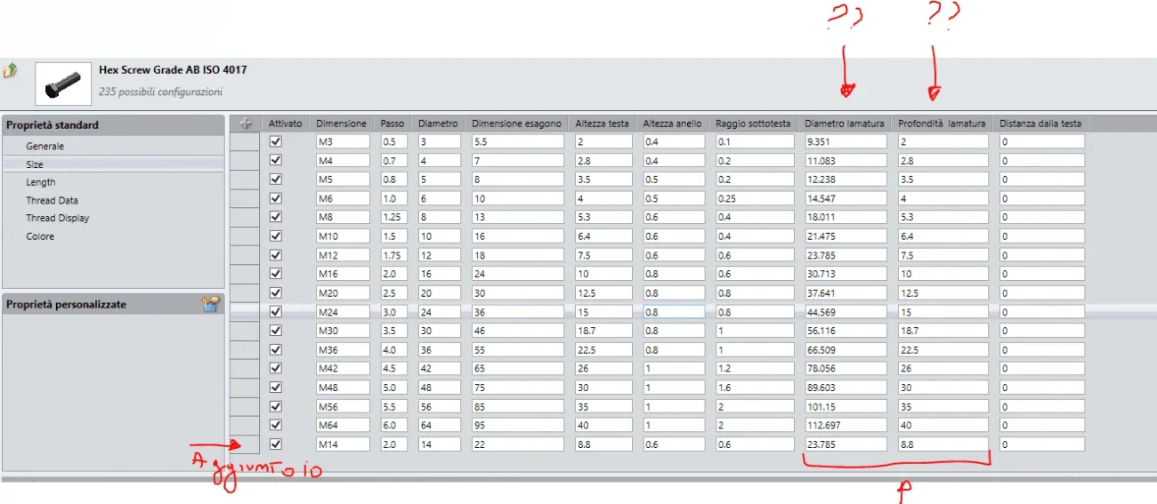

good morning to all,I am always in the grips with the toolbox,I have to add a dimension to the screws the m14 that does not exist in the list of iso 4017,so that in the insertion of the data asks me 2 values that absolutely do not know what they are
I'll put on a picture
1546086266548.webp Can anyone help me? ? ?
we are talking about hexagonal screws, what do the lamatures do? ? ?

mechanical excuse, but what does "can still cash" and in the end what value I have to put on that box, there is no indication of what that quota means
Can you do a sketch to figure out what that diameter refers to? ? ?

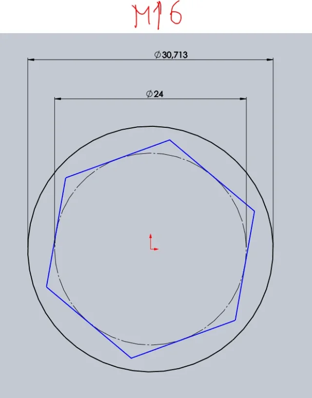

I believe that the diameter you want in the toolbox table is related to the only pass of the head1546103490795.webpI took the m16 data that there are the tables

with a compass, but I do not understand what centea does this with the initial question, I had to understand what the diameter is rofetivated and I believe thanks to the input of mechanics of having understood what they refer to (see 2 attached image) you agree massive? ? ?
