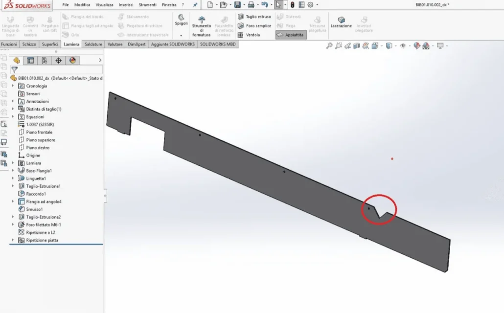

I'm modeling an angle sheet, with corner flanges, I have to realize both the right part and the left part, the sx I will realize it with the control mirrors part, now, when I go to flatten the sheet on the mirrored sx brings me the discharge, while in the original strangely not, you know how to indicate the reason?
place a couple of pictures to make the idea better and if you also need the original row.

How is that cut in the original?
how is the sheet not flattened?
the mirrored part you converted it into sheet metal or is it already such at the time of mirroring?

- the cut in the original does not show the discharge.

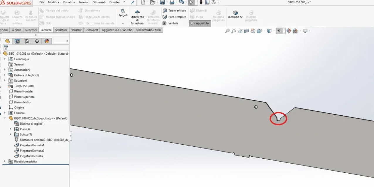

- looking at the unflatten plate the discharge seems to me to be there or in that part is made different from how it is then seen in flattened.
- the mirrored part is converted as you see from the image and also presents the flattened discharge as placed in the image above.

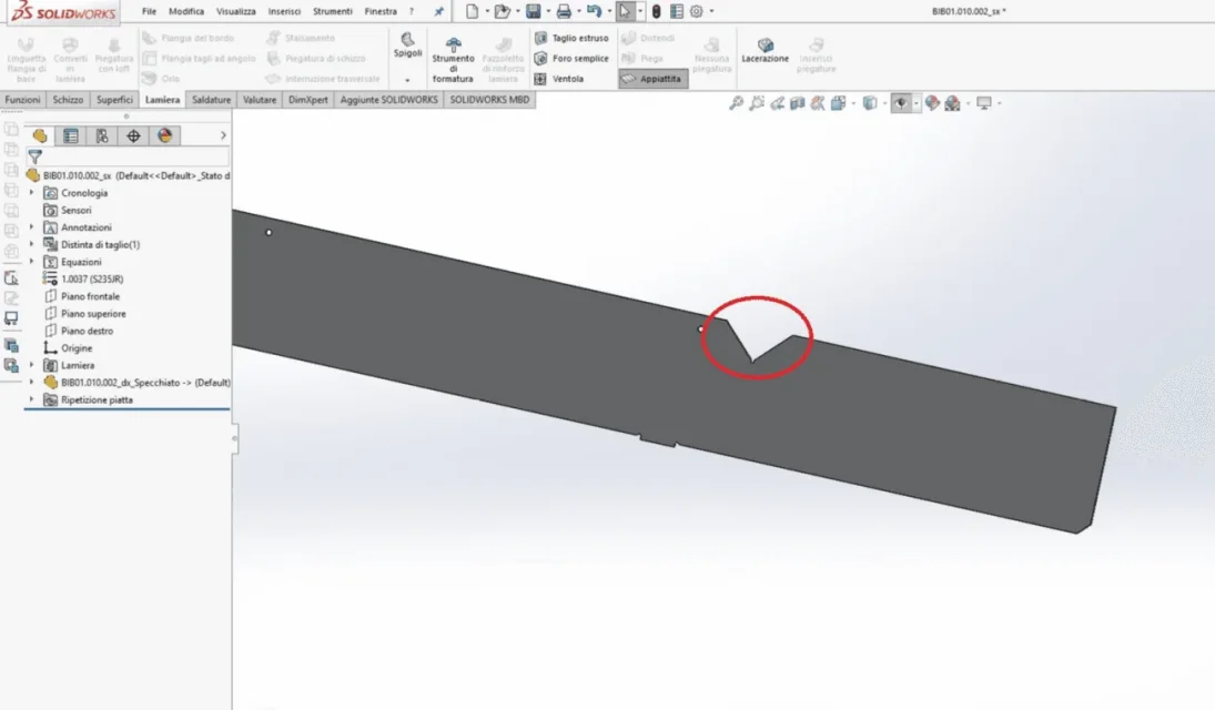

thanks 1000 boulders, very kind, I place you an additional image of the mirrored part, what do you mean with convert function in sheet metal? the part I mirrored it with all the functions of the original, however when I make the flattening in the mirrored part gives me the discharge, while in the original instead not.
is one of those improvements that were made with the sheets; If I mirror my sheet I find a solid without history, as if it were an imported and I have to convert it into sheet metal. And anyway I find it unloaded.
