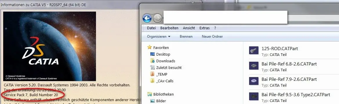

with v5r20sp07 and w764bit previews from us are visible
I did a couple of things. However I still do not see the previews in the window to the right from catia.
hello falonef, with the sp07 the previews are always visible?
both part, product and drawing?
because we do not always see the previews and not all the files.
If I have a folder with 100 catparts I can see maybe 90% previews.
look I do a Monday test on a folder containing cv5 files from 2003 until today then from ca. v5 r8 up and let you know
