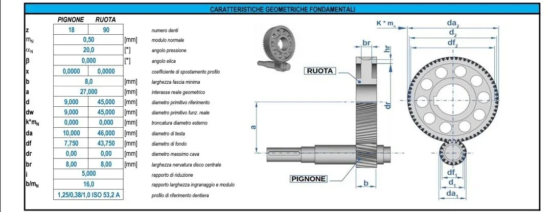

I'm dealing with the first accounts I've done... and I'm noticing that I've considered that within 4000rpm in the first stage and that's all right. But then unfortunately in the various accounts I considered half the turns... that is 2000rpm. So I've got to go over it.
I again attach the full and magazine version.

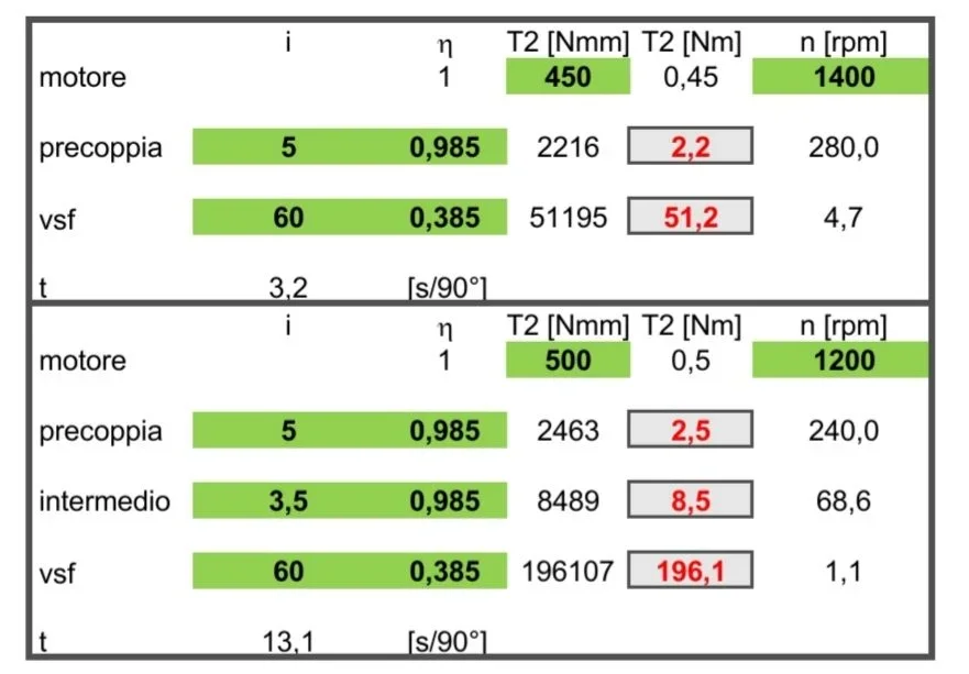

so at full efficiency I 90nmm a 4000rpm supplied by the engine and the gear train turns as from the following table:
Cousin Stadium:
Second stage:
third stage:
room stadio:
as you can see having worked with couples and not with the powers have not changed much the results. the values for the wear duration are varied, turning at different regimen.

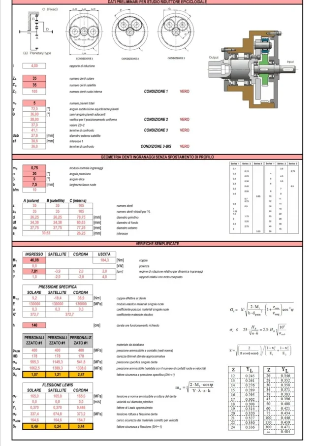

I used the sintered material with elastic module and similar properties.
as before we 3rd and 4th stage that are not able to bring the couple.

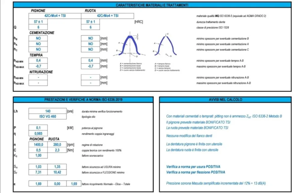

Cousin Stadium:
Second stage:
third stage:
room stadio:
as you can see having worked with couples and not with the powers have not changed much the results. the values for the wear duration are varied, turning at different regimen.I used the sintered material with elastic module and similar properties.
