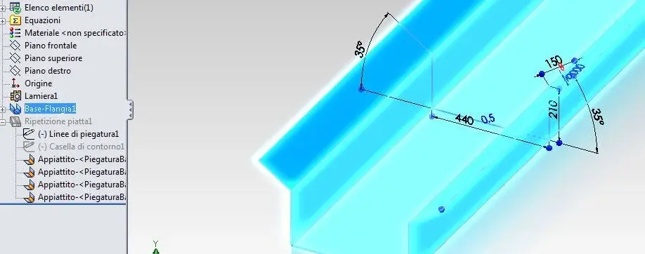

... hello to everyone, I repeated this section with various measures, on new files but every time development gives me error.. .
...and even is such a simple section ... :confused: :frown:

reggio has happened many times to me especially when you do the flange on the intermediate plane. . .
try to turn off the fold, flatten and return to fold. after which it reactivates the fold. It usually works!

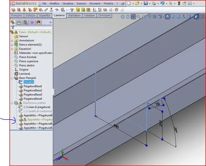

Yes, the "problematic" is that, the profile and way to run it as well.
just opened your file is fine, everything regular. but if I enter into a sketch and define it or change a relationship, on the return part jumps out the notice and misses a fold.
after a "random" series updated list of items and reconstructions return to place, but if I try again to change something it turns again daccapo.
if I model a new part starting from your sketch (copy and paste) the error gives it to me immediately and I solve only suspending and reactivating that missing fold. . It remains the fact that with subsequent modifications to the sketch you will hang again and I have to remake all the correction procedure.

I uploaded both files and gave me no mistake, except the flange that is logical.
for the flange speech, you cannot have thickness 0 at that point.
The laser would also make a mistake.
the laser must follow a closed path.
try to rebuild it as part and then add the folds, as I usually do.
for the section then, select it first and then add the folds.

I open, I find the mistake, I flatten and the error disappears no longer appearing.

...make the flange at 90° instead of 45° and... no mistake... ?
Now I try again at 45° and tomorrow I try to re-ri-do the section on the pc in the office, maybe I also unload the sp4 ... indeed I see that it is "sp4 ev"?? ? then no, thank you, I wait for the sp4.0
