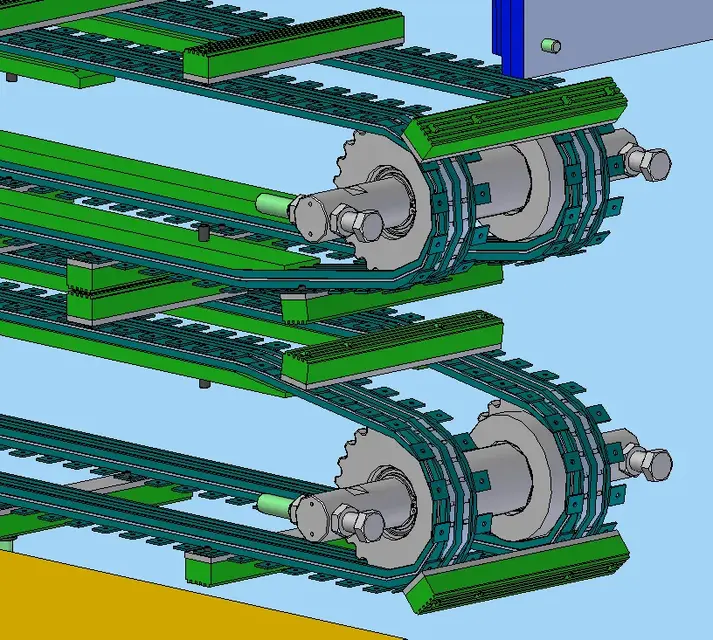

Look, it's actually a feature I use sometimes. especially for belt or chain conveyor belts. I leave you an image of a real application.
