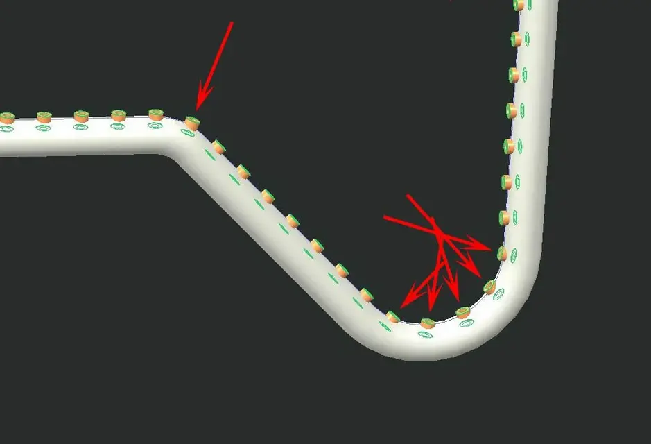

from your video you see, because I will have a few hair but I have an eye, that the series of holes does not follow the normal to the guide gurva. especially at the end of the video, in the image I attach, the components are definitely out of alignment. You gave me a whole red pencil and you charge it. the red arrows are gross in axis with the pins and you see well that more than turning around the center of the curve seem thrown by the Indians
I add, to further infiler, that me and hunt have both posted the video with in the order:
