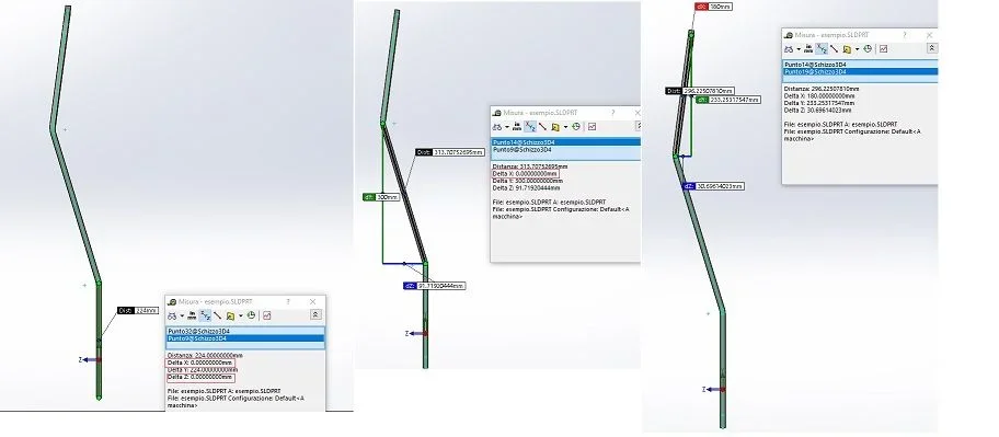

And my memory has escaped from the fence for a long time. . .ale function does not work for 3d sketch at what I checked.
How could I do this?
No, that's not the problem.I see you have time to ask other questions, but not to answer if you managed to do what you were advised
from the sum you will subtract the length of the cut. always fancy obviously.the tube was created with a 3d sketch and then it was cut to a certain height; I find it difficult to measure the length so.
Fortunately the length of the cut was vertical.... if it had been tilted were about....ifrom the sum you will subtract the length of the cut. always fancy obviously.
I would like the plan to have the same inclination of the line and that the line belongs to the floorpasser? What does passing mean?
Make a sketch of how you want to have the plan.
I would like the plan to be exactly the one highlighted and that it did not rotate around the linethe top can rotate on the axis (line) 360°View attachment 46864
