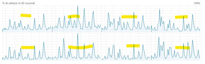

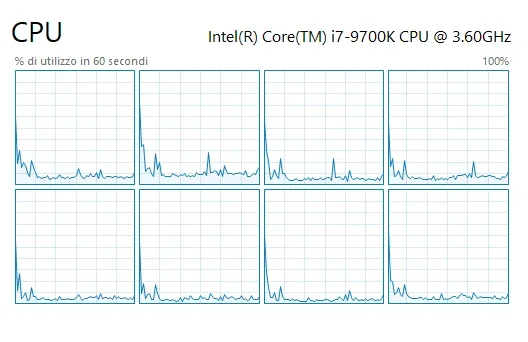

it mainly uses one but others do something, they are not as zero as in the second image1698063576899.webp1698063609181.webp
Okay, so that's how I always knew.
uses only 1 core, others manage other system processes.
