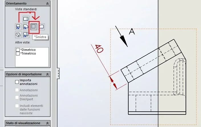

In practice I have to use a second auxiliary view to put that quota, correct? ♪if the right view from which you get the view to the eye on the other side, then with the hidden rib you can quote the thickness 40 (which takes the eye of a sniper to see the red circle)
but so doing as quoting ribbing then? Of course I can not share parts not in sight.if the right view from which you get the view to the eye on the other side, then with the hidden rib you can quote the thickness 40 (which takes the eye of a sniper to see the red circle)
You're right!from a view from above that you seem to have already done

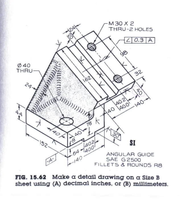

probablyis more understandable if I hold suspended the fitting functions (and then in the 2d do not appear ) and add a note "fillets and rounds r8"? ?

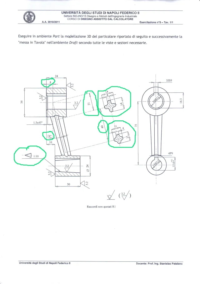

make a revolution excavation using a line with an inclination of 1:10 (with reference to the diameter of the revolution) then starting from a diameter of 13 on one side and 3mm on 30 on the other therefore diameter 16.Bye.
I realized the 3d of the model in figure.
The only thing I didn't understand is how to create embossed conicality.
Sorry but I didn't understand.make a revolution excavation using a line with an inclination of 1:10 (with reference to the diameter of the revolution) then starting from a diameter of 13 on one side and 3mm on 30 on the other therefore diameter 16.
in the view on the right of the sheet is indicated diameter 13, and is the smaller diameter of the conical hole. 1:10 conicity means 1 mm of diameter variation every 10 mm of hole length. that hole is 30 mm long then with that conicity the greater diameter will be 3mm more, that is 16 mm.Sorry but I didn't understand.
from the definition of conicity, if I did not hurt the accounts the smaller diameter should come of 21.
where d= 16 and l=30.
conicity should be defined as (d-d)/l, then (16-d)/30 = 0.1.
Am I right?
Here we go.in the view on the right of the sheet is indicated diameter 13, and is the smaller diameter of the conical hole. 1:10 conicity means 1 mm of diameter variation every 10 mm of hole length. that hole is 30 mm long then with that conicity the greater diameter will be 3mm more, that is 16 mm.

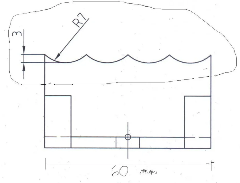

to make the width 60 and the 4 sequential arcs coincide, these must have width 15 (60/4), which cannot combaciar and with radius 7; assuming that it has the minimum useful radius, i.e. 7,5, the center would be hilly with the tips and measure 3 would be 7.5.
to have that repeat result the total body size must be 45.95 and broken
