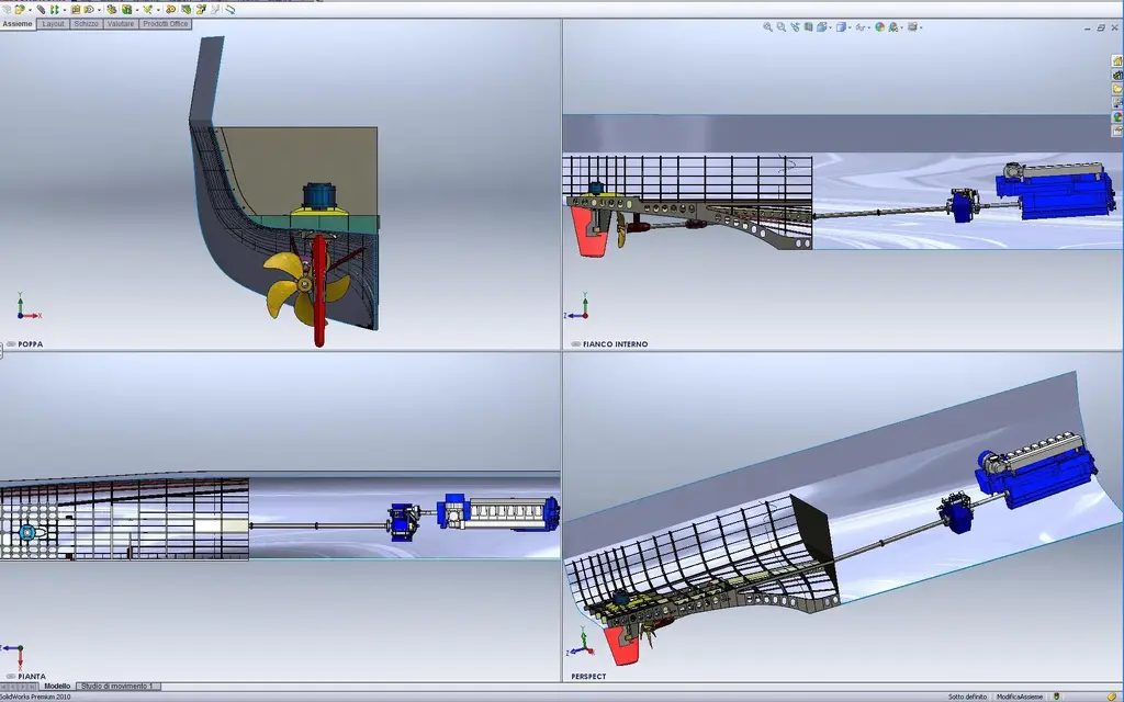

..any "projection":MEZZA POPPA.webp
We reach 23 knots.
you have to find the reducer (at least 2:1) because 600 rpm are too many.
greetings
hi dragon, well found:smile:.
this is the propeller we have provisionally mounted, obtained "drawing" your previous:ELICA D2850.webpView attachment ELICA.rarlook if it could go and tell us about the calettamento (the tree terminal has become a "flange", like the ram? )

size is becoming important, it begins to be difficult to grasp the detail from an image.. but in the meantime:POPPA 38mt.webpHello

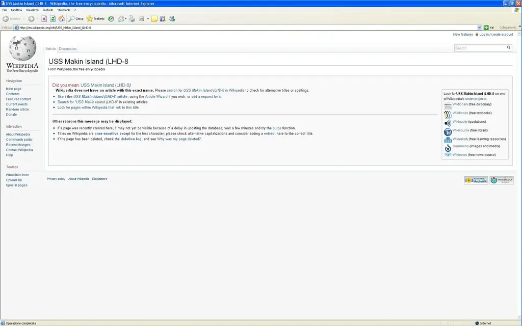

put this string in the search for English wiki.
uss makin island(lhd-8)
What a strange thing!
continua a dirmi: oops! this page appears broken
I'm out of this.Immagine.webpI'm not coming. .
